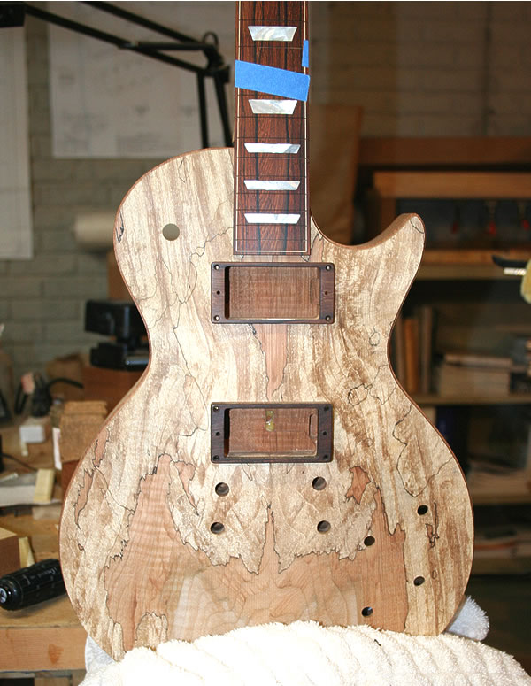

Mahogany is generally my favorite electric body wood, I think it sounds good and looks great.
My LPs are 1.75" of mahogany and a top cap of just over 1/2" carved. The top plates are generally 3/4" give or take when I start the process.
Here is a construction shot of a spalted one.

Brock, I love the figure on that, And the fingerboard... Well, that is going to be a nice looking guitar.
PostPosted: Fri May 11, 2007 7:42 am
Posts: 684
Location: Nashua, NH
Wonderful Brock!
That one has "Hand crafted" written all over it!
Great choice of woods.
Are you making knobs too?

PostPosted: Fri May 11, 2007 7:43 am
It is getting rosewood knobs.

PostPosted: Fri May 11, 2007 7:48 am
Posts: 4820
Geez Brock, why don't you talk about electrics more? You always post
great pics of them. This one's in construction right now? People on The
Gear Page are always posting shots of carved tops that run in the same
range as custom acoustics and don't look as impressive as yours.

Pretty Brock! (The guitar I mean...not that you're a bad-looking dude or anything...it just isn't something I'd normally say! ) But, the guitar's a beaut! Is it for you or is it a "seller"?
PostPosted: Fri May 11, 2007 10:23 am
Brock--WOW!--that's fantastic.
You make the coolest electrics.
PostPosted: Fri May 11, 2007 10:45 am

PostPosted: Fri May 11, 2007 2:22 pm
[QUOTE=Brock Poling]
Brock, when you use a huge piece of spalted wood like that do you toughen it up with CA or Polycryl, or just put your regular finish on it?

PostPosted: Fri May 11, 2007 4:27 pm
It depends on the piece. Some is pretty hard and I use it as is, others is so punky that I pour in as much CA as it will take.

Brock: nice guitar! Is that fingerboard bound, or 'just' fitted with purfling?
Spalt's funny stuff, and getting good quality, not too checked, not too punky material is a challenge, but it's certainly worth it in terms of looks!
